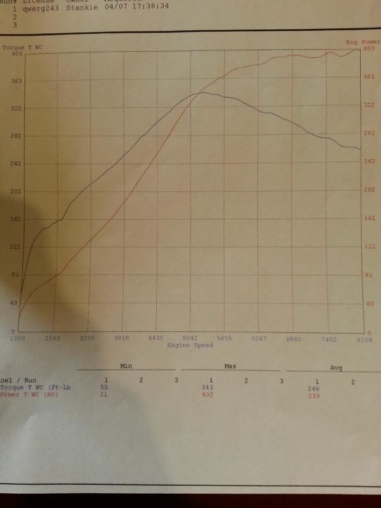

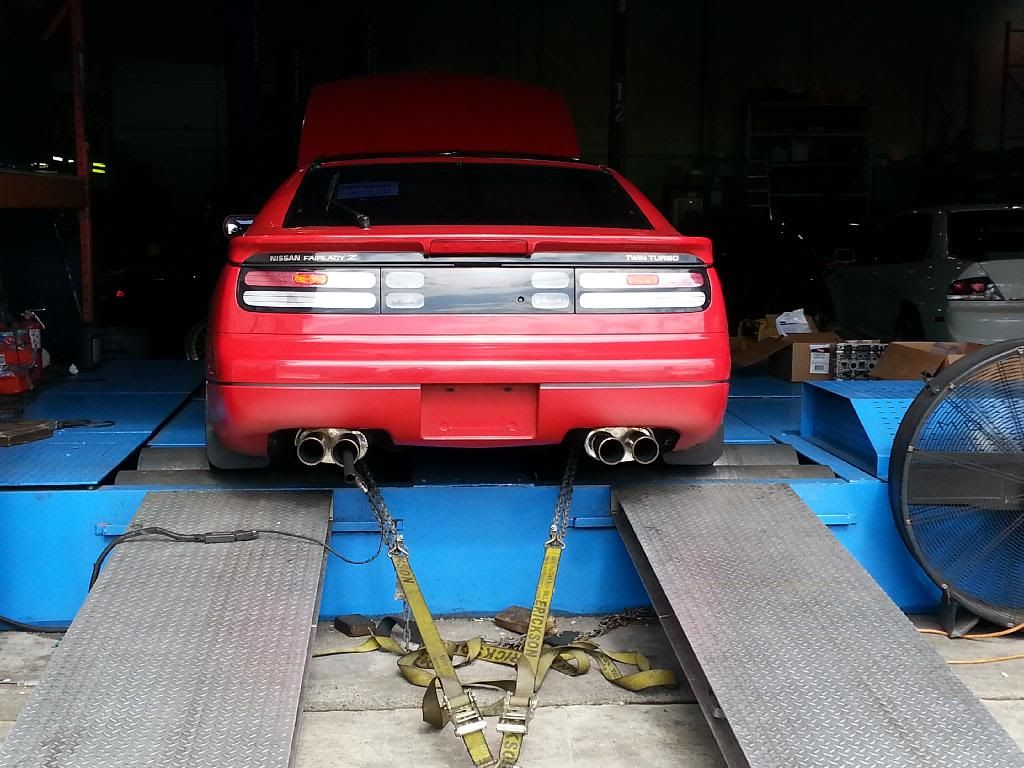

Message Got dyno tuned today, and made MUCH less power than I believe I should be making. Dyno'd at 402wrhp @15-16 psi, and whats worse is that it only made 343 ft-lbs.. I have the Sport 530's, and I was under the impression I should make full boost by 4,000rpm, but this thing is a LAG MONSTER, and it wants to keep making more power in the high rpm which also makes me scratch my head..usually the 530's will start to choke out in the higher rpm's
I had a boost controller problem, where is pretty much wasn't working...we couldn't get it to go above 12.5 psi, so we put in a manual boost controller that instantly allowed us to up the boost.
Once we got the boost up, it held fine. I had the timing set as well prior to tuning, did a boost leak test last night, no codes etc. Looking for where to go next as far as tracking down this lack of power. Mods are up to date on my profile
